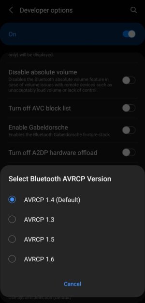

Not crazy about those head units , but go into developer settings by Tapping build number 7 times go to Bluetooth settings there and try different configuration and see what works . You can also see how your phone with another cars Bluetooth if u have a chance but try developer settings.
I did what you said, went back to settings and searched "Bluetooth", wow there are a lot of BT settings. What should I try?
First and last picture try those settings, just remember or screen shot your stock values
I tried every option in your screenshots, plus "turn off AVC block list", and "Bluetooth audio LDAC codec: Playback quality" to "Optimised for Connection Quality", I also deleted cache, and reset network again. No luck.
