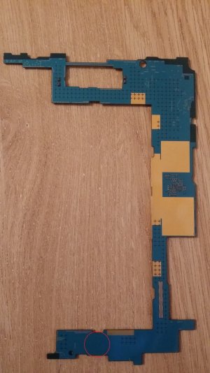

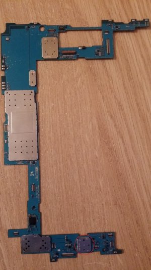

Hi everyone,
I'm really hoping someone can help me.
I have a Samsung galaxy tab s2 8inch. It is the SM-T710.
It was working fine playing music on a Bluetooth speaker system then the battery died.
Tried to charge it and it was acting funny, said it was charging then got to one or two percent and i attempted to power on while the device is on charge and it powered on then turned off within a few seconds.
Let the tablet charge for a while now and its not really going up and the screen has gone off and its not turning on and i now notice its getting really hot at the bottom part of the screen slightly above the home button.
Removed the charger and left it for one hour, then came back and tried with a different new genuine Samsung charger and cable, and still getting extremely hot within a few 5 - 10 seconds just above the home button.
Unplugged it and left it till the next day and attempted to charge it again same thing.
I though it could be either: A faulty battery or A faulty Micro USB charging port flex (possibly short circuiting).
Now Ive opened up the whole device and taken apart every item on the mother board following a tear down video on YouTube.
https://www.youtube.com/watch?v=UB1ovCcEyFc
I then connected a brand new genuine battery to the board and removed the old one, and the device was still overheating however this time i could pin point the exact source of heat on the motherboard which i will circle on the images that Ive attach to this post.
I then thought the micro USB charging port flex is causing a short circuit and so i completely disconnected that and the overheating problem still occurred.
Then i disconnected each and every component one by one and still the same thing on the motherboard keeps overheating excessively within seconds of connecting the battery to the motherboard.
Now Ive completely removed the motherboard from the frame and Ive connected the battery to it and same overheating issue.
Now Ive reconnected just the micro USB charging port back to the motherboard and attempted to plug a charging cable into the port and exactly the same thing still overheating excessively.
I really do not want to replace my motherboard simply because of the data on the device etc.

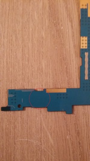

Can someone please tell me what the red circled item is in my image so i know what is overheating!
Could it be the CPU?
Is there ANY other way to replace JUST that part, even in china? Can anyone advise or help me?
Many thanks to the people who patiently read this and helped.
Kaiser
London, UK

Wow, it seems like you went through a lot to troubleshoot this problem. Before the teardown, did you perform a factory reset? Perhaps it was a rogue app running in the background?
As far as the circled piece, I'm not quite sure what that is. Hopefully someone else can chime in and provide further answers.

Hi Kaiser
Any resolution to your problem?
I had the exact same issue with the same model last year and it is still open wide waiting for some miracle..
I changed as well the battery and the micro USB charging port flex with genuine parts but the problem still remains.
The red circle should be some controller for the battery charging that overheats due to some short circuit, but just a wild guess.

Before consider a different mainboard, try this fix as it's common in Samsung tablets: cracked solder joints of battery connector will cause overheat and other charging issues
https://www.youtube.com/watch?v=DaAKjmrMR2s
