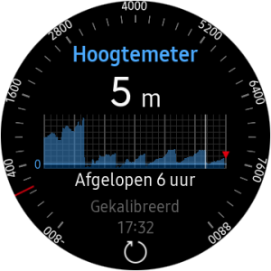

I just found out that the calibration frequency is related to the update frequency you set in the weather app on your Phone. So to improve the altitude calibration you may want to try to increase the frequency with which the weather app on your Phone updates. Below picture shows wat happens with the altidude values if you change the update frequency from 6 to 1 hrs.Screen_20190312_181312.png

I just found out that the calibration frequency is related to the update frequency you set in the weather app on your Phone. So to improve the altitude calibration you may want to try to increase the frequency with which the weather app on your Phone updates. Below picture shows wat happens with the altidude values if you change the update frequency from 6 to 1 hrs.View attachment 299872
