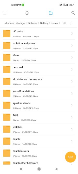

You would have to create the folders through a File Manager (just like you would on your computer). Then move the actual picture/video files from the Camera or original folders into those new ones. Your Gallery should display each folder as a separate 'Album' (not too familiar with Xiaomi phones, so not sure how that looks, but the functionality should be there, just not sure if you have to select a specific 'view' type or if they'll display the folders right away like most Gallery apps do).
Again, never used a Xiaomi phone so not sure about their back up options and what it includes (it may just be like other picture managers, where only the files are saved but not the 'virtual album' sorting).

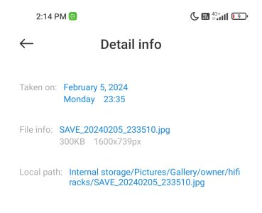

Again, not sure about Xiamoi phones but the fact that the path includes 'Gallery' makes me wonder if they are actual folders. Take any picture or video inside a folder and select to see its details. Does the individual path show those as folders?
Ok
Here's what I did as you suggest
Went to the gallery app
Then went into one of my albums
Called " hifi racks
Selected a picture
Went to " see details" about the picture
This is what came
Huh... weird, that IS a different folder. I wonder if Photos is seeing the main folder (either "Pictures" or "Gallery") as the camera folder. For example, on Samsung Phones, screenshots get saved directly to the camera folder so, even though they are in a sub-folder called 'Screenshots', Photos backs them up as part of the main camera folder. Try setting up a test folder with a few pictures outside the Pictures folder and then select to back it up as an 'external' folder in Photos. Did that work?
This is how I would do this :
If you have folders for each album on your phone, open the Google photos app and upload only 1 folder at a time to the cloud. Once that folder is backed up to the cloud, open Google photos on your phone and create an album pertaining to these photos and make sure they are all there.
Repeat the process until you've uploaded each album, 1 by 1 into Google photos.
