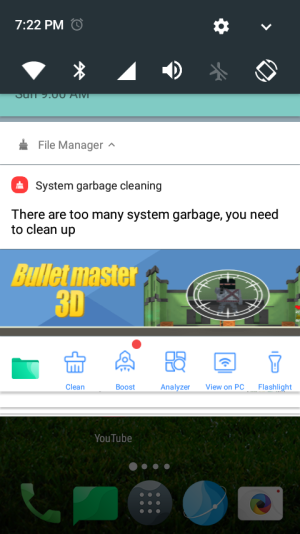

Hi, I'm OP. Thanks to everyone who's replied! I'm attaching a screenshot.
Other points:
1) My phone is an Alcatel Raven LTE.
2) Yes, I was confusing memory with storage. Oops!
The weird thing is that I definitely never deliberately installed any such third-party file manager/'phone cleaner' app. I'm getting constant suspicious notifications from File Manager, which is not third-party as far as I'm aware. Should I delete it anyway?
I found a solution to removing system garbage cleaning from an alcatel phone.
I saw a question from IndyIndy about this. I had the same problem. It's the File Manager application. I was able to go to Settings, Apps, pick File Manager, then go down to Store. It said the app was installed from the Google Play store. In the store, I was able to pick Uninstall. It's finally gone! Hope this helps others.
Thank you so much. It helped me getting rid of this annoy thing!
