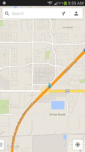

Good morning,
I'm experiencing an issue with Google Maps, wherein the blue dot's (my location) arrow seems to point in a direction other than the one I am traveling in. Is or has anyone experienced this issue, and if so, is there a remedy? Also, is this a hardware or software issue with the Note 3 or is it something to do with the Maps App? As you can see from the attached screenshot, the arrow is pointing in a northerly direction, while in reality, I am actually traveling south bound on this freeway. Screenshot_2013-11-12-09-59-15.jpg

Re: Google Maps Compass/GPS Issue
I think it's a Google issue because it did the same for me with my old HTC phone too.
That was my thinking as well. It also seems to be a compass issue, since, to my knowledge, GPS simply calculates location, not direction.
I'm getting that as well. The heading is never exactly correct and I had it in a previous phone. I think eventually an update took care of it.
I turned off most of my "smart" features such as the eye motion detection and other advanced settings, and performed the "figure 8" calibration and now my compass heading is correct.

Some people download a Compass app and some people just turn on any app that uses the GPS and then they do what the guy is doing below.
I have this same problem, but ONLY while in the car. It is really annoying, since the older versions of google maps worked just fine.
My theory is that the car causes a lot of magnetic interference (surrounded by lots of metal, near an alternator that generates a magnetic field) that ultimately renders the compass in your phone useless. The older versions of the google maps app used heading with GPS positioning, now it is using direction with the compass.
Why they made this change, I don't know. It would make more sense to either use a hybrid of the two or allow you to decide in a setting. Heading with GPS positioning works well when you are moving, but not when you are still or moving slowly, in which case direction works better with the compass. The BIG monkey wrench is that the engineers/developers obviously didn't consider that most people would be using google maps in a car where the compass doesn't work very well.

I have this problem in car and also when navigating on foot. Newest version of maps seems to correct my direction right when using car navigation, but on foot navigation still uses compass to show my direction. It's usually 45 degrees off, and it's always been this way on my GS4. No calibration seems to affect this. It's sad, sometimes I'd really like to navigate city streets also on foot! :-\

I can't say for sure that this will fix your issue, and I can't say scientifically which step solved MY issues... but I can say I was having a hard time getting a GPS lock and I did 2 things and now get a rapid GPS lock with much more accurate measurements.
First, I took the back off and tightened all of the screws. Most of them were very loose from the factory.
Second, I installed an app called GPS status & toolbox.
Maybe one worked and the other did nothing. But I can say that now I at least get a fix quickly (after the initial GPS fix is established), and that I get accurate directions, whereas before these 2 steps, I thought the phone was defective.

My fix was very simple. I removed the back-lid and tighten all the visible screws. After this my GPS was up and running. I tried a lot of Apps but none could get more than a couple satellites on board. Any GPS fix or accuracy was non existent and google maps was lagging all the time and putting the map backwards or sideways, missing roads etc.. This happened some time after getting my display replaced for a new one and been driving with a Smartphone holder (which vibrates quite a bit). So i'm guessing the guys at the shop did some sloppy work at tightening the screws and the holder in my car took care of the rest.
Still have a wrong direction indication while standing, but i think there is a setting in google maps to calibrate your compass for the car, home, and work or something
