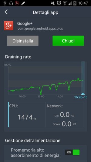

Regarding the battery consumpion...same here with my S5 as well. At first there were no problems, and therefor prety satisfied about the battery consumption.
I installed Battery Doctor and noticed that Google+ is one of my major battery consumers. On Google+ Location, sharing is off. Google+ only sychronizes when WIFI is available and when power adpater is connected.
