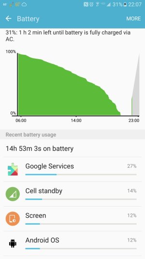

Yesterday evening after getting home, I started to notice the phone getting a bit warm. Outside temp was in the 60's and indoors around 75, so no ambient temperature conditions that could have contributed.

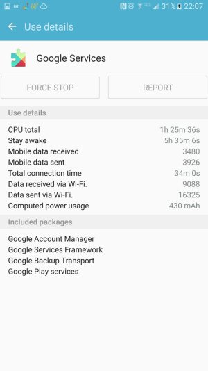

Upon further inspection, looks like Google Services process(es) got hung up and lead to a lengthy "Stay Awake" state. Battery went from ~ 40% upon arriving home around 630pm to 0% before 9pm. First time I've ever let the battery get that low or go to the point where the phone shuts down on its own.
I did take a few photos at work and thought perhaps that Google Photos was creating some warmth due to the phone working harder during the backup process (backup set for WiFi only). In either case, one or more Google Services processes appears to have been the source for the rapid drain.
Anyone else experience similar problems recently?

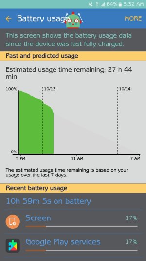

My Note 5 is running a custom ROM that doesn't have Google Photos even installed on it. I started noticing Google Play Services being high on the battery usage stats over the last week or so.

The only apps I installed over the last few weeks was Google Maps, Gmail and YouTube. I deleted them all and will see how this goes. I don't use Gmail or any of those apps that much to where I would miss them. Maybe this will solve it.
Much better today after deleting those three Google Apps. I may try adding them back one by one to see what the problem app may be but I'm not in a hurry to do so. Google play is at 10%. It's getting lower as I use the phone now.

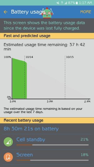

Nice. I am pretty sure it was Google Maps for me as well. The ROM I am running had no Google apps at all except the play store installed. I installed Google Maps last weekend and that's when I started noticing the problem.
After a day, I can still say that it made a difference, but not as much as I had hoped. I am still draining battery at twice the rate my Note 7 did, but that is still an improvement. I am consuming on average about 4% per hour with light use, but before locking down Google Maps, I was draining closer to 7% per hour.
