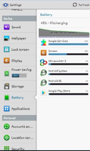

Here's my battery stats, shows my phone was being kept permanently awake:
Good detective work! And yes, Google Play Services always auto-updates--you can't turn that off (at least, not on an unrooted phone).
Thank you B.Diddy :) (little glow of humble pride from a non-techie female). Lots of posts with the same problem popping up everywhere the past few days. Really hope Google are listening and release an update soon.
