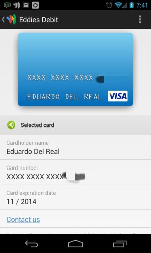

My took 3 minutes, but eventually went through.

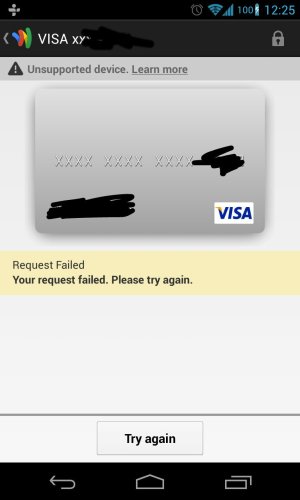

Good to know I was going by Eduardo screen shot that didn't have the unsupported device message.

Wallet works with rooted phones just fine. You get the "Unsupported Device" disclaimer banner but otherwise it's 100% functional. Not sure why some of you are having issues but I would just keep trying. I guarantee you that root is not the culprit.
