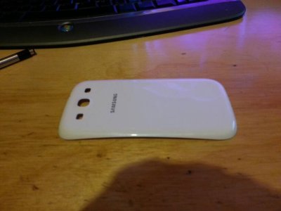

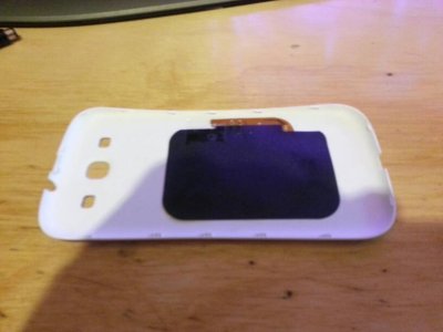

It was one of the pre-made backs on ebay for about $28. Its a tight fit, but it locks right in place and WORKS! Charging rate is around 250 mA, which is a bit low, so it will take longer to charge than directly plugged in, but I charge overnight, so that's ok. Temperature is no higher than on a direct charge. The magnetic hold keeping it in place on the touchstone is good. When placing it on the touchstone, the S3 responds it is in range of a charger and lets you know its charging.
All in all, looks good.

Also... show some pictures, please

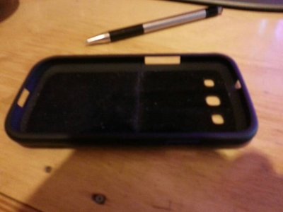

My case is a Seidio, fairly thick, and no, it doesn't charge through it.

Still waiting for mine to get here. Got my warranty Otterbox in the mail yesterday, If I can get it to charge through the rubber outer case, I'm going to use a hole saw on the inner and see if I can't get it to work.
I was thinking of something similar.. but I'm going to try it on some of the cheaper cases first! Otter is great at replacing their cases, but methinks a 2" hole in the back might cause them a problem!

So, to start with, I bought a couple of "pre-fab'ed) (how's that for a pun) SG3 backs with the Palm charging coils & contacts in place. I got 1 on eBay, and one on Amazon. About $28 each. They were different in manufacture & layout - on one, the coil & metal disks were centered on the back (for landscape use, mostly), and on the other the placement was biased toward the lower half (so the GS3 could sit in Portrait mode without bottoming out against the tabletop/car console / whatever the Touchstone is on.
I tried this set-up au-naturel, and it seemed to work quite well - although the GS3 did not "stick" to the touchstone very well.
