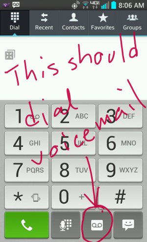

When I am in the phone app, there is a voicemail icon in the lower right. This button apparently does not call voicemail, but starts the voicemail app. That does not help me since the same error occurs every time I'm on wi-fi.A dialog saying "Visual Voice Mail subscription error" "Please turn off Wi-Fi network to complete the subscription process."
Of course, I have "completed the subscription process" 5 times on different occasions (usually when I have voicemail) to no avail.
