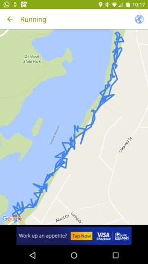

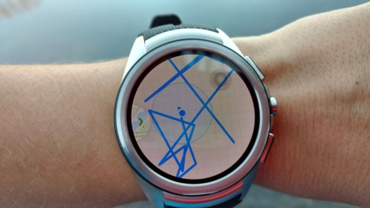

Endomondo showed me zigzagging around my trail yesterday, including running on water, and it showed almost 3 times the distance I actually ran, see pics attached.
Factors to consider:
- it was below freezing
- GPS signal on that trail is always a bit tricky, and even on my Gear S used to go in and out
- I do not have a SIM card in my watch, and left my phone in the car
- I was streaming music over BT during my run
I have done all of the above before with no problem. Has anyone else seen this happen before?
I wonder if the GPS is the part that presumably can malfunction in "extreme conditions"?
I got the same results with GhostRacer (amazing app!!!) yesterday. Maybe there was a solar storm...

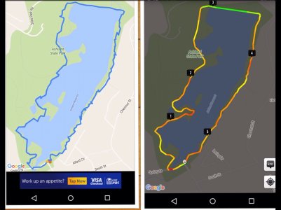

Today, it did not act crazy, but it did count an extra km vs. what Nike gives me for the same trail on my Gear S and my phone. Upon close inspection of the differences, it could be that Nike measures a straighter run than the trails actually allow. Or maybe not? Very confused... See pic: Endomondo on LG watch on the left, Nike plus on the right (two different days, but same trail).

So would you say, then, that between the two pics you see above, the Nike+ tracking is more accurate because Nike uses cloud servers?
If you have to use the GPS to measure your track distance, yes, Nike+ does a better job because it filters out those GPS jitteriness due to limited accuracy by calculating a simulated route that best matches your actual route in overall scale. The raw GPS data in this case is quite useless for such direct measurement unless you move at much faster speed, e.g. bike, motocycle or car, anything that moves a few times of accuracy bubble per second. Unfortunately, such calculation is quite resource heavy and complex.

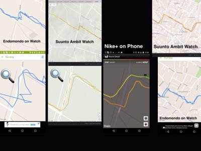

Quick update on my end. I wore a Suunto Ambit (3?) on the other wrist yesterday, then compared the distance and maps with Endomondo on LG watch on the same day (left pics below), and the same trails tracked with Nike+ on my phone on a different day (middle pic).
All the way to the right is a different part of my run where I ran in a neighborhood in a straight line.
While not perfect, the Suunto shows me mostly running on the actual road and trail.
Distances tracked:
Suunto: 6.36 km
Urbane with Endomondo: 7.59 km
Phone with Nike +: 6.33 km
Is this along the line with your experience? Has anyone tracked runs with the k8 or Sony SW3, and how were the results? I am thinking of just buying a second watch to wear only on runs. I already sold my Gear S. I hear the S2 is less reliable than the OG Gear S as well, so maybe putting the GPS antenna in the (bendable) band is not such a grand idea.

There is nothing military vs non-military at the play here. The problem could be band stretching, bending, or contact with skin. Maybe this is the reason for the recall. I will try to put a piece of fabric/foam between my wrist and the watch band.
BTW, the watch GPS works perfectly well when it is off the wrist!
I tried carrying the phone in a pocket yesterday, and it indeed tracked as well as my phone.
Today, I had the band closed to about the middle hole, and hiked the watch up on my arm. This got me the best results so far, on the first half (3.5 km), then zigzagging for the second half, which was the exact same trail. I was really sweaty underneath the watch by the end of my run, so I wonder if sweat may affect it. I wore it next to a Suunto, and during the first half, the LG only added about 10% distance as compared to the Suunto, then on the second half it went crazy.
Next test will be wearing it on top of one or two wrist-sweatbands. This will allow me to not have to tighten the band all the way to the second hole, and will keep sweat away from the band.
