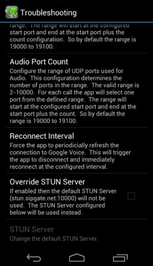

All the time I watch the status of GrooveIP, it keeps dropping when I'm not using the GNex, even though it has full connection to wireless. Then I unlock it and it's connected again. Can anybody explain why? This not only happens on the GNex but my Droid X I still have.
You can try going into the settings menu, then choose Troublshooting. There is an entry called "Reconnect Interval", if your connections aren't holding, this will have GrooveIP auto force a disconnect/reconnect periodically through the day.
Found the setting. For ten minutes a steady connection after sleep. I'll keep that in mind in the future. Thanks.
