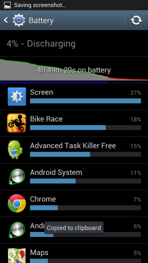

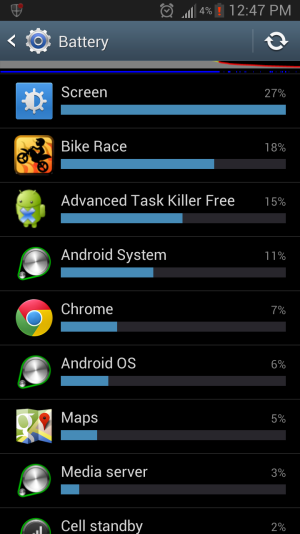

Okay so my battery is getting worse and worse I've had the phone for about a week. Bought it oft eBay. Now to the point. today it lasted about 5 hours of light use. Played a few rounds of bike race that was it. I have the free version of juice defender, power saving enabled, and screen brightness on about 35%. And I was on wifi with 4g turned off and sync and GPS off. I am running 4.1.1. Check out the pics not sure if they will help.

Uninstall task killer! That doesn't help your battery because phone has to keep reopening apps... Your phone can manage apps especially with 2gb.. Try that and report back

I got loud with att and they sent me a new phone but not a battery. Gay. I have everything reinstalled except juice defender and task killer and my phone with data off GPS off and screen 1/4 brightness I'm at 93% withreally no use after an hour and a half 36% cell standby 23% screen. Is that what I should be getting? What is the average discharge you get with use over an hour

It depends a lot on how good the signal is where you are. Plus, typically, although the phone will say 100% after you unplug the charger, it's probably a little under that and you'll see the number drop to 97% or 98% within a couple minutes.
When I'm connected to wifi (that turns off mobile data) and there are about 2 bars of cell/voice service, I burn about 2.5% an hour. If you're not on wifi, expect that burn rate to go up unless you're right next to a tower. LTE towers burn your battery faster than HSPA towers. Finally, if you have any apps that poll on a regular basis (email, facebook, twitter, etc.), that will use a little bit.
Say your starting point was actually 98% when you unplugged it, that means you burned about 5% in an hour and a half...that's around 3 to 3.5% an hour. If your cell service is weak-to-mediocre and you're not connected to wifi, then this burn rate seems perfectly reasonable. If you have GPS turned on, that could contribute, too. Make sure you turn that off when not in use.
And I agree with Photo4glover about the app killer. Don't install those: they're completely unnecessary and could do more harm than good (Android 2.1 and older had a tough time letting go of programs, that's why all those task killers exist.)

Okay thank you both. Still not happy with the battery life but I'll see how it plays out. I love the phone though. I'm coming from an iPhone 4 so I was spoiled when it came to battery life. Thanks for all the input.

A while back I installed juice defender and noticed my power took a nosedive (an oxymoron, I know). Uninstalled and it went away. I have Advanced Task Killer installed and have never experienced battery drain from it. I would think it requires much less power to reopen apps than those open apps constantly polling towers. Once a day I clear out RAM to recover memory that is hogged by background apps, and notice as many as 44 apps are killed at once, freeing up as much as 700MB of RAM! I also regularly use AAK manually to kill those background apps, and have the kill frequency set to its highest.

The problem with task killers is not that they eat up battery. The problem is that they force processes to quit and could potentially bork up your phone because it expects something to finish that never finishes. It could potentially send the processor into a tailspin, heating up the phone and draining the battery. If this happens, rebooting the phone is the only way to reset everything.
All those processes going on in the background are happening for a reason. If you kill them in the middle, you can corrupt their files and lock up ram that's dedicated to them. Eclair and older versions of Android (that's 2.1 and older)...and possibly even Froyo (2.2)...had issues with not releasing apps or killing unnecessary processes. Those issues were resolved with Gingerbread (2.3), making the task killers unnecessary. When the phone needs ram, it kills the processes that it can, and kills them safely.
Although using a task killer hasn't yet caused you any problems, it's safe to say that it will eventually bite you in the you-know-what. Bottom line: the risk associated with task killers far outweighs any potential benefit.
