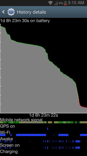

Even over night, it's draining 5 percent an hour. Before jelly bean it would drain about 1 or 1.5 percent an hour.
Please help!

One thing..your LTE signal..2 and 3 bars for it. One thing you might want to try is disabling LTE and see if that helps, just to try it.
I see you haven't rebooted or pulled the battery. Pull the battery for 120 seconds and see if that helps. With AT&T many of us have experienced some issues in LTE areas, off and on..but what we had was a huge plummet. I only had it once, I went from 100% battery to 10% in 6.5 hours, while I was asleep.
You have used it 12 hours, got 23% left and looks like many of those apps have sync options and updating options. I don't sync or update anything but my google account. I have far less of those type apps running than you do and I get about 18 hours and a heavy days use, I get about 15 hours.
Your screen is the #1 drain, but it wasn't on that much over that 12-hour span of time. Do you have the brightness at 100%? This isn't the plummet as the drain seems pretty uniform. Must be a combination of LTE high drain rates plus a low signal. I notice a few times during that span that your cell service cut out (or was too weak to get picked up by your phone). If the signal fluctuates a lot where you are, and disappears or gets very weak, that will destroy your battery life. The only problem with that theory is that "Cell Standby" would be way higher than 7%. So I'm not sure that's the problem either.
First, just try rebooting the phone before you go to bed and see if that helps. Could be a rogue process that would be cleared up via reboot.
If not, if you have wifi in the house, turn it on and connect for one night and see if that makes a difference. If it does, then it's an effect of the weak signal you're getting.
If not, you might have a bad battery or a lemon phone. You can probably get a replacement battery from your carrier and test it. If it is still draining really fast, it could just be a hardware problem with the phone.

Well, it's not awful, but it's not awesome, either. That's about a 6% drain per hour. He reports that his drainage increased by 2 or 3 times, though, so I was just addressing possibilities for the change.
I generally get about 2.5% drain per hour when I'm at work (with wifi on). After upgrading to JB, that jumped up to 5% or 6% an hour. It sill got me through the day just fine, but I was kind of OCD about it and it really bothered me that upgrading the phone led to worse battery life. I did a factory reset and my battery usage is back where it was originally...around 2.5% with light to moderate use.

Having read all the comments, it occurs to me that I should compare the battery drain when on WIFI vs. LTE. My 5% overnight figure was WiFI I believe.
I just shutdown and pulled the battery, topped off the charge and will re-try the test.

I wanted to check a couple of things on mine, to see about the deep sleep, etc..I installed the Better Battery app, paid version to do this. I had something waking up my phone off and on and couldn't figure out what it was. This told me what it was and I went deeper in the settings of the app and found out that yes, there was a deep setting that was making this app update every 30 mins. I also have one that is updating about every 10 minutes, but will go to every minute when triggered by an event, but it is a severe weather radio and alarm and I live in tornado area, so it needs to do that. I really liked that app, made it very, very easy for me to pinpoint down what I had been looking for about 1.5 weeks now. I put it on and charged up the phone and then checked what was going on while my phone was asleep. I had about 1% battery loss in 6 hours.
1 percent in 6 hours? That's amazing! Does the app you mentioned give more information than G Sam battery monitor which produced the screenshots in my original post?

Btw, just charged up to 100% and turned on phone, am running on wifi. 45 minutes after powering up, I'm down 3% and media has consumed 5 minutes of CPU .
What the heck is media doing?
Thanks for any ideas,

That media is a bit of a bug sometimes. Every once in a while I get that too. Pull the battery, let it sit for 120 seconds, then turn it back on, throw the charger on it again to get it up to 100 and see if the media stopped. Either it settled down for me or I finally disabled something..as a "computer person" something running like that using resources, that I'm not needing, bugs me. I'm sure you understand lol
