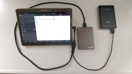

Most external drives should work with an additional power source, and formatted to Fat32. Here's my setup with a Seagate Backup Plus 2TB drive (USB3), OTG cable plus Y splitter USB cable to get power from the power bank. I use it as a backup drive for my PC too, so have anything that's readable on Android available.
