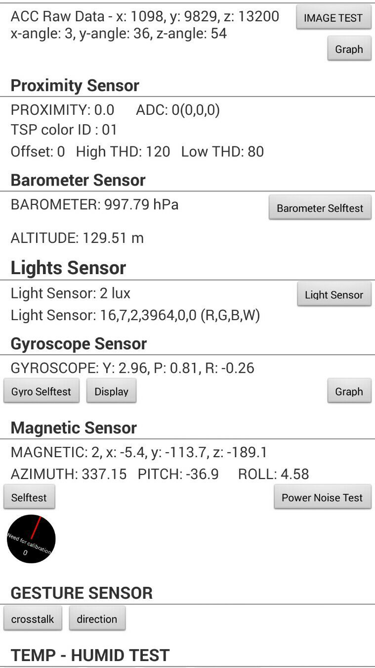

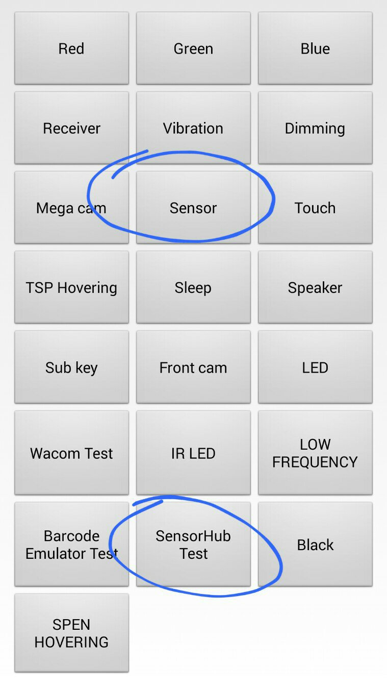

There are 2 sensor tests in this screen service code thingy. *#0*#
Sensor hub test gives a pass or a fail after a short wait, Sensor test gives you a running readout on most sensors. I know nothing about it apart from that. @SebasCvdB pointed me to it for an S-Pen test.
You can see if some hardware is not working.

Hi Mad54, I went to the one at Westfield. I thought it's the flagship? In sensors test, I got no read from several sensors, gyro, temp, etc. Sensor hub test is passed.

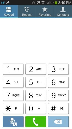

Speaking of that service code thing, *#0*# I try that on my Verizon phone and nothing happens. What gives!

On the videos the call board has blue buttons with black background. My board is all white with black outline. (Ugly board)

Not sure what you mean. Can you get something like above.
**OK Gotcha. Phone keyboard and call log is like mine in Sam video, blue on black, and Verizon have put their own scheme. No service numbers then. There were 1 or 2 others but they must be locked as well. You're probably getting a better overall deal than me though. :)

My phone keyboard.

Ugh! Do not like that AT all! What did you do to Verizon?
Still I guess looking on an actual screen it may be not so bad.
Blue on Black is a bit utilitarian and its been like that for years on Samsung's.
So on second thoughts I could get used to it. Thanks for showing. :)
