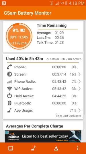

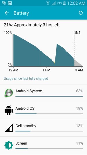

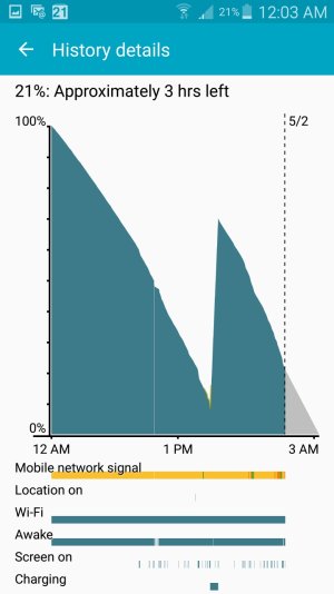

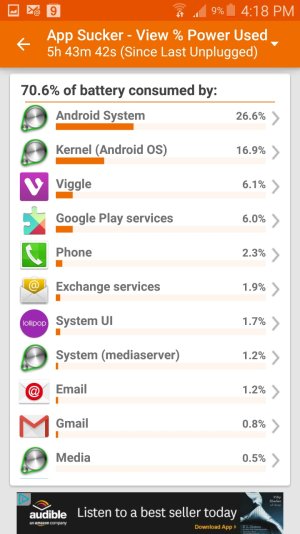

I am attaching screenshots that will hopefully make more sense. Maybe I just worded everything wrong. Regardless, the battery is horrific!!

Those screens look about normal - except for the about 1200mA drain and the almost 5 hour awake time. Run Wakelock Detector (if the phone isn't rooted, see Wakelock detector with non-rooted phone) to see what's keeping it awake.
Also let's see screen shots of the Battery page in Settings and (by tapping the graph at the top) the next page. You might have a bad phone signal.
