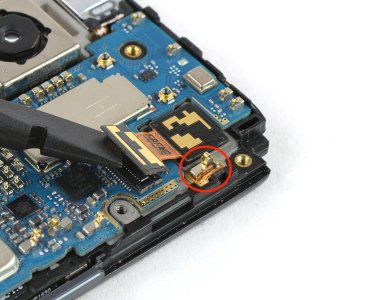

Whilst attempting to remove the motherboard cover this part fell off. Anyone know what it does?
I'm not sure if it does anything. I looked on my V20 and it's just a spring loaded contact point. From the tear down video, I didn't see anything connected to it. I also have an extended battery with a TPU cover to replace the stock back cover, and no ill effects other than a loss of NFC (which I don't use anyway). Look at your back cover and see if anything on it lines up with where that little point would be. I.e. A circuit trace on the inside of the cover.
I don't think I'd be too concerned about it for now, though.
Thanks for the reply.
I've put the part back in place with a little touch of glue. It's odd though as its mounted to a tiny pcb it doesn't appear to have been connected to the motherboard at all.
Since reinstalling I notice that I'm getting a lot of call drop outs when driving along a route I've not had issue with prior, possible hand over issues? possible antenna issues?

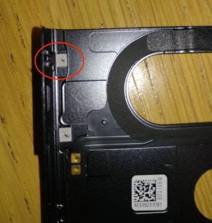

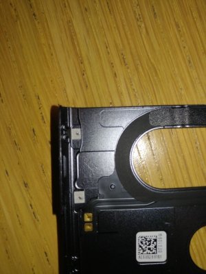

Its contact point on the inside back cover is circles below.
Does anyone know what this contact point relates to?
I've been having issues with maintaining a connection when driving lately too. Both for calls and data. I'm sure it caused a 911 operator a small heart attack when it dropped a call to them and took a bit to reconnect to a tower to call again (thankfully it wasn't critical). It's so bad now that it's one reason I'm finally looking at replacing the phone. Fyi, this is on Verizon.
I did some more digging about those contact points. According to this thread, they were intended for a replacement back cover to enable wireless charging, but those covers never came to fruition.
https://forum.xda-developers.com/v20/how-to/lg-v20-wireless-charging-support-t3486488
So I think there's nothing to worry about. Given the age of the phone, LG isn't going to spend the time and money to develop a new product for a phone they no longer support. Not to mention much of the V20 user base has already moved on to other phones. Those contact points serve no purpose other than to make us ask questions.
