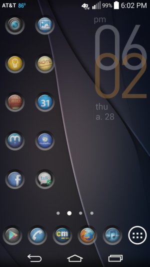

I reformatted the 128GB but I'm afraid to try to re-install it. My G3 has been on 100% for about 4 hours now unplugged with the 64GB SD, mostly on standby except for the few things I check on, but still I don't remember it ever lasting this long at 100%. I have Battery Doctor and GSAM Battery Monitor installed. The face of the phone as well as the rear buttons are absolutely cool to the touch. Sorry guys but unless I get more problems I'm not messing with it.
EDIT: Make that about 5 hours at 100%.
Other things I've done for these results:
Once the G3 is operating with less battery drain (from swapped out SD card) I Use LG Backup service and back up on the SD card.
Next I Factory reset
Next restore using LG Backup file on the SD card.
I'm using a Sandisk Ultra 64GB with a 10C rating
I did all of this around 12:30pm
Finally shows 99% after 6:PM
What icons are those?

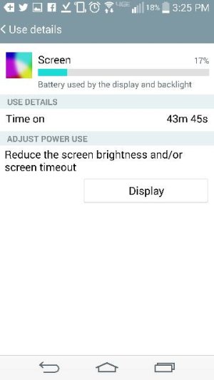

I work in a hospital, and notice that at work, my battery goes from 100% down to approximately 25-30% in less than 8 hours. This is typically with less than forty minutes of screen on time! I turn data off and use Wi-Fi only and keep brightness down, close apps, turn off location etc... I tried taking out the sd card once, but it didn't seem to make much difference.
I thought it was due to signal searching, as I get close to 3 hours screen on time at my home (still not great)...with data and Wi-Fi both on. But my colleague has a note 4 (also Verizon) and his battery maintains 77% with Bluetooth, gps, data, Wi-Fi all on, and similar hours and screen on time.
Please help me. I appreciate it greatly. Am I doomed among all the hospital electric noise, and if so...why me so dramatically?
