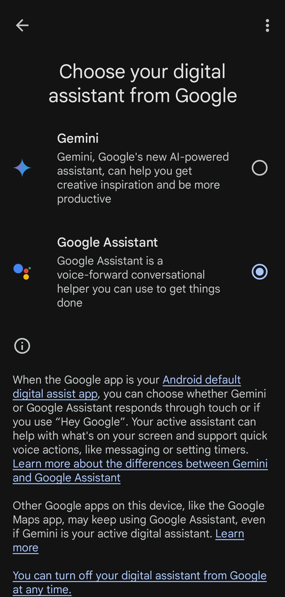

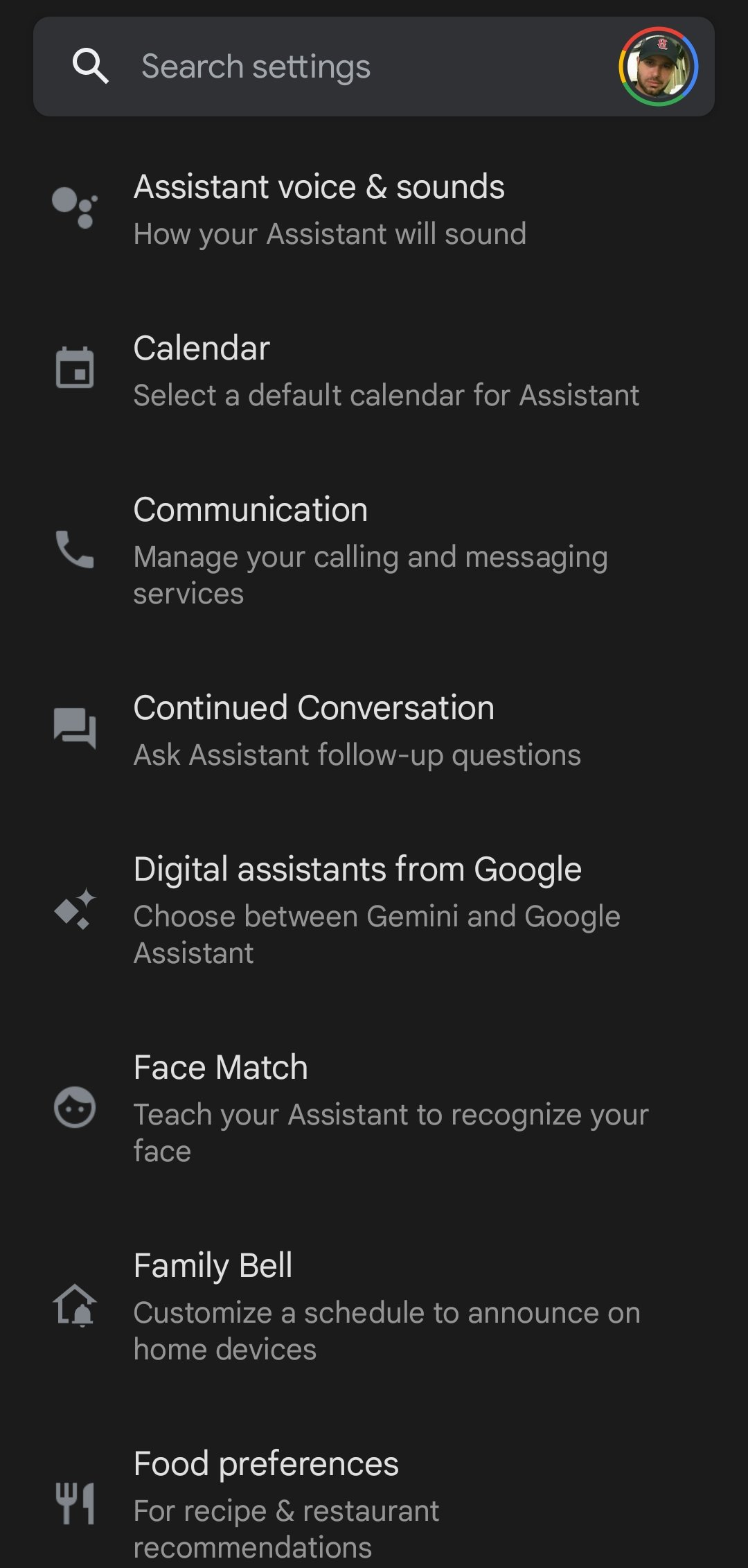

Ok looking over this make sure Google assistant is set to your assistant, open Google app >Google assistant tap then scroll down to digital assistant from Google tap is Gemi or Google's assistant selected there?

Yes, Google assistant is the selected one (not gemini) Trust me I tried everything. So did the Samsung customer support remotely, she tried for two hours.

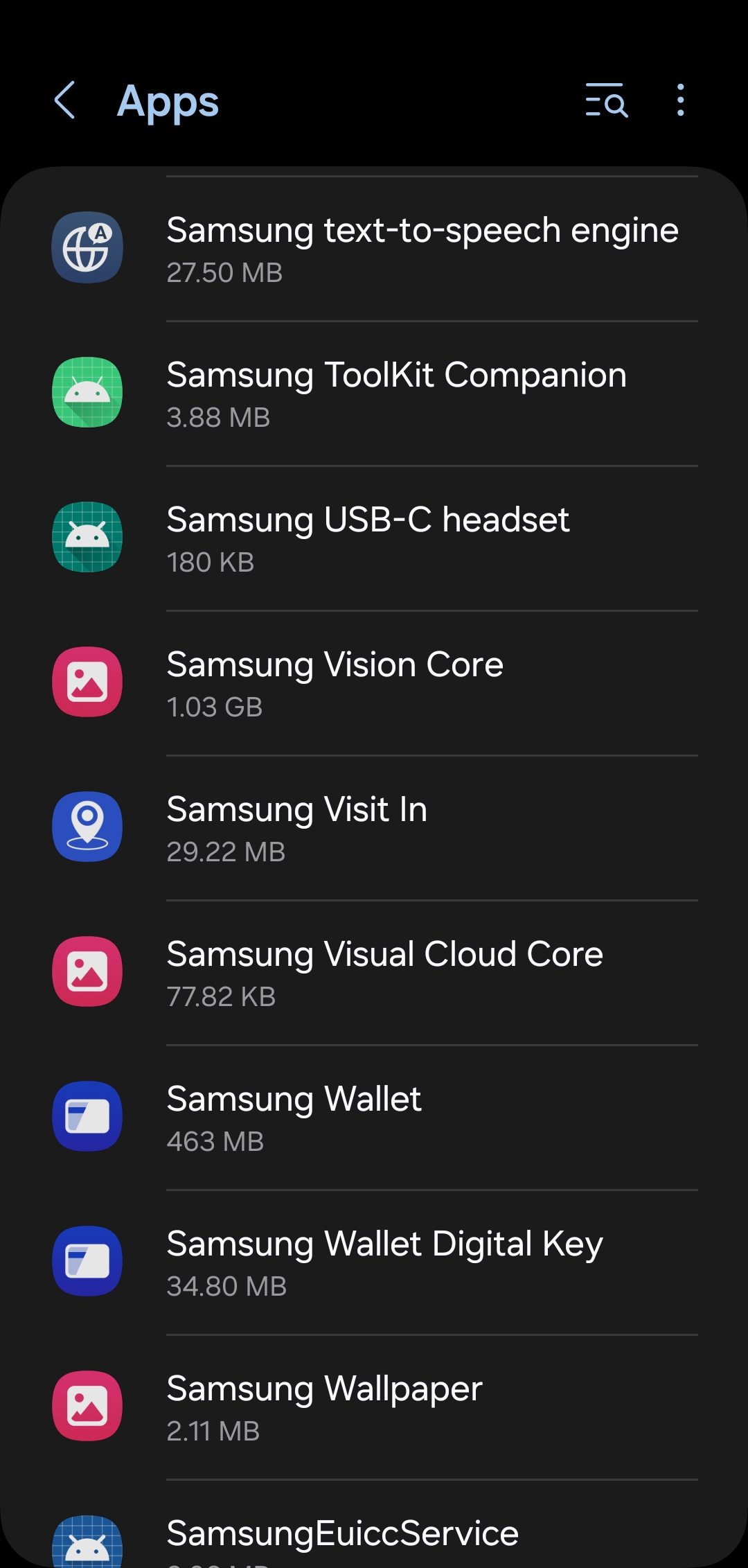

Also go to settings>apps>turn on show system apps , scroll all the way down to you see Samsung USB c headphone set and tap>go to storage clear Data and force stop it
My friend has another s24 ultra and it doesn't work on hers either haha. Yes it works perfectly for music and calls, the headphones are brand new and I tried with other ones as well.
Yes, I tried to use it with the switch that's what I always used to do with my other phone, when I had the phone on my pocket I would press and hold the button for a sec until it rings like a bell sound and I would tell the assistant whatver I needed. It doesn't work with this :/ I just tried clearing the data of the USB-c from apps and nothing. The person from Samsung did thst as well yesterday, she tried so hard she spent 2 hours via smart tutor. It's a fuc**ng mistery, but I hate having to take out the phone of my pocket at the gym or when walking because I'm not able to use the assistant, I was very used to it.
I think until I shows under Devices on Google Assistant settings it's not going to work, I'm sure you see wired headphones with your AKG right? It would be stupid to return this phone because of this, I won't, but it's not the same, and I had a way worse phone before (an A72) and I miss it, well this should work but I don't think it's going to happen. Thank you so much for trying to help.
