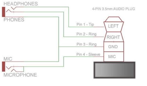

I'm trying to use the headset jack to connect to the more powerful stereo amplifier for so that I can hear the thing. I've already made a cable and discovered that connecting the output wires to the input wires was pure folly and has no useful effect at all. I have found useful information about how this interface works but there's way too much long winded elaboration on proper screwdriver operation instead of schematic diagrams.
Try this:
Audio output is the tip and first ring from the tip. Ground isn't the shell, it's the next ring up.
