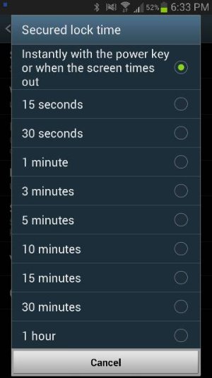

Did you adjust the "secured lock time" settings?
Sent from my SAMSUNG-SGH-I317 using Android Central Forums

Here's what you do.
1. Settings > Lock Screen > Screen Lock then set your pin
2. On the same Lock screen setting screen > Secured lock time > Instantly with the power key or when the screen times out
Done. When your screen times out or you press lock key. Press lock key again and it'll ask you to enter the pin.
As stupid as it sounds, this screen lock is considered "Secured lock" which requires another timing set up regardless of your display time out settings.
p.s. You don't need to lower this secured lock by 15 seconds. You can have it locked instantly or whenever your other display time out setting kicks in. This feature is to allow people to not having to put in the pin every time their display is turned off, but only if it's off by X minutes.
