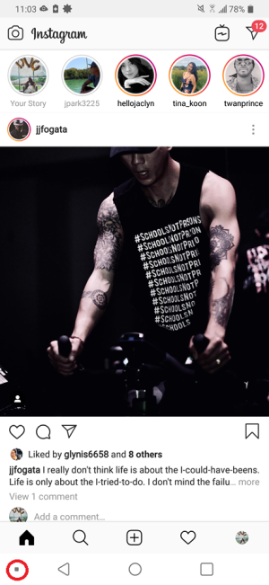

I had the same issue and it's not really obvious to fix... if you swipe up while on IG there is this tiny little square dot. Click on it and it'll lock the home screen and that should fix the issue. 51741950_2198688006859529_8311245812113866752_n.png
I had the same issue and it's not really obvious to fix... if you swipe up while on IG there is this tiny little square dot. Click on it and it'll lock the home screen and that should fix the issue. View attachment 298045
THIS! thanks for taking the time to screenshot? Make sure to close instagram and reopen on your feed to see the little dot. Every once in a while an IG update will override these settings
