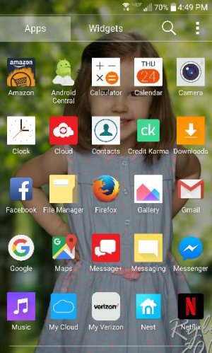

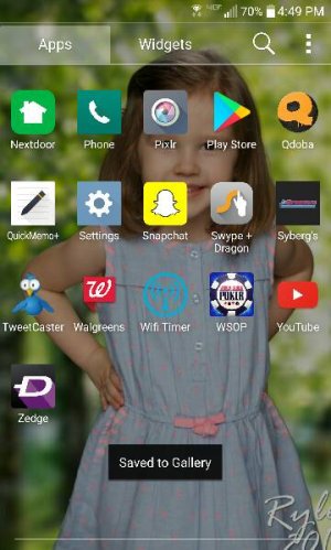

Verizon wants me to do a factory reset and install one app a day and see when it starts to drain fast to locate the draining app. In the battery usage there are no apps showing excessive battery usage. I have like 20+ apps and I would hate to install just one app a day, I'm hoping to find a faster way to find the issue.
Why not just list your apps so we can try to guess?
Do you have Facebook or Facebook Messenger installed? If so, those are always likely culprits.

Here's all my apps.
