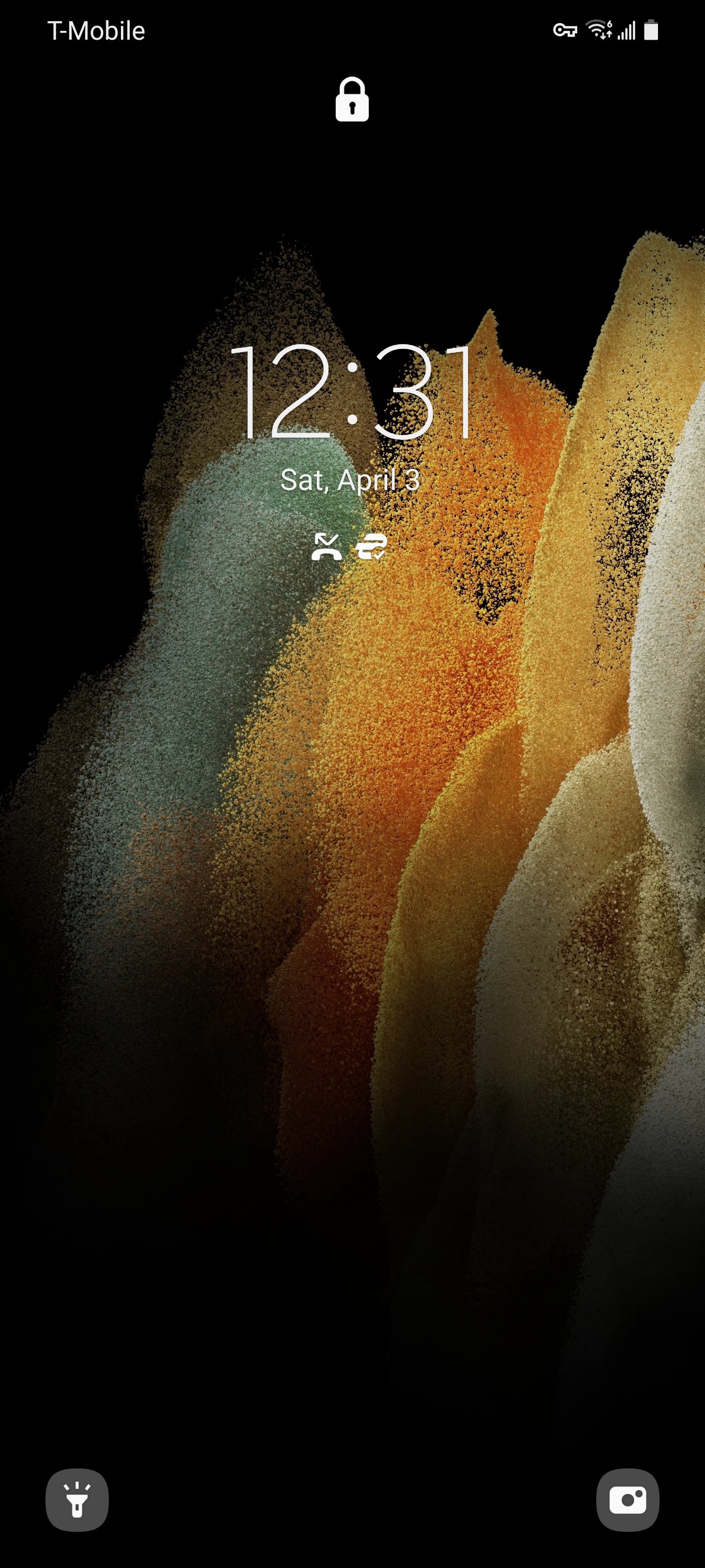

bhatech
Trusted Member
Nov 21, 2012
7,932
716
113
Visit site
Re: Help needed please - Phone app not showing "missed call" notifications on lockscreen and AOD
Hmm I didn't show the missed call until I unlocked the phone. But once I unlocked it shows on the lock screen after I lock it again.

bhatech
Trusted Member
Nov 21, 2012
7,932
716
113
Visit site
Yep doesn't show missed call on the AOD or lock screen until I unlock the phone once. But after I do that it shows (screenshot in above post).
As far as reporting to Samsung, try Samsung members app. My personal belief is Samsung sucks in terms of caring about customer service and stuff like this. So you might not get anywhere but doesn't hurt to try if you want. If you don't have Samsung members app may be try reporting there I guess.
Now let me change back to Google dialer again and be happy to use my preferred Google apps
