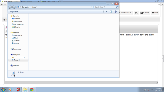

I would try it, but im unlocked. Use a pattern though so the idiots I work with won't mess with it while it is charging. I would think that if your locked and have a lock screen, you wouldn't be able to access the sd card. If you can seems kinda pointless to have one, since one benefit of having a lock screen is to prevent people from seeing your pics.
So even though you are unlocked (knowing that the OP is not), can you try it on your pc? I'm curious to see how secure a pattern lock is.
No dice. I turned off USB debug and developer options, plugged it in with the screen off and locked and nothing. I can see the N4, but when I click it, it says 0 items and shows nothing. Once I unlock the screen, everything on the sd card shows.

Then I guess the OP is hosed and you have peace of mind regarding your security. Thanks for checking.
Yup no prob. I never actually thought about it untill this post. Puts me at ease a little knowing that it does prevent most people from accessing your phone.
Having a screen lock pin/password for your phone means that you can not access files on the computer until you actually put the pin/password in. Great feature if someone has stolen your phone but not so great feature in the OPs case. The only way the sd card can now be accessed by plugging the phone in is if a factory reset is done through recovery. Unfortunately doing a factory reset through recovery wipes the whole sd card defeating the purpose for the op. Unfortunately the op's problem would have been so much easier if he had just enabled usb debugging in developer options (adb and fastboot are great for pushing files, pulling files, etc when you cant use your phone). Alternatively if the op had a custom recovery installed he couldve done a factory reset which would not wipe the sd card, but would wipe away the screen lock allowing him to access the sd card from his computer. Unfortunately again, the process of installing a custom recovery involves unlocking the phones bootloader which again wipes the whole phone including the sd card :(
