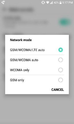

I'm on T Mo and don't see that as an available option in the network selection area.

Phone idle had crept up into the teens on my Verizon V20, so I checked network settings, and it had switched to global. Reset it to LTE /CDMA and phone idle has dropped to under ten percent. Don't know what the best setting is for Tmobil, though.
