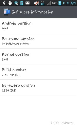

I have tried the Root With Restore By Binary v 31. Followed all instructions. I have the drivers and it does not work.
Heres my phone Software information

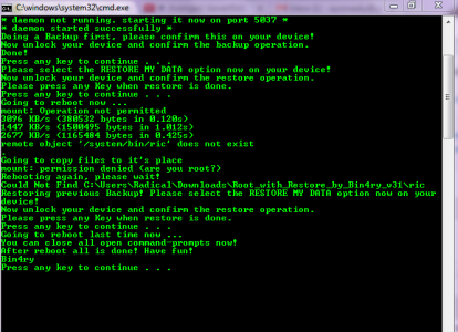

Heres what happens when i try root
Please help. it keeps saying im rooted but im not:-X:-X
Root zvi and use voodoo ota rootkeep to get zvk rooted
Sent from my LG-LS840 using AC Forums mobile app
Yeah. No root method for zvk so far besides using voodoo or superuser
So, after a long battle, and many forum searches I finally compiled all the information together to actually successfully root the LS840.
The short answer is, Bin4ry's script for Windows (and presumably Linux) does work, what isn't as clear is that it doesn't work on the latest firmware. This thread points it out, and this is the most recent posted thread regarding the subject anyway.
I don't take credit for this and if I'm forgetting someone I apologize in advance. This post is simply to be a one-source location to pull together the bits and pieces to successfully root this damn thing while opening as few tabs as possible :)
1.) Confirm your firmware: About Phone -> Software Information -> Software Version: If the last letters are ZVK, and if you've had nothing but trouble up until now, it probably is... you have to flash to something older. ZVI for example. If you have ZVD or ZVI... jump to the "rooting" step.

Now that you have the ZVI firmware installed (confirm it! you can root it. I found that Superoneclick 2.3.3 & rageagainstthecage exploit didn't work.
I'm using Win7-64bit Home Premium, and Norton Internet Security Suite (Comcast) and disabled it, but still didn't work... thankfully Bin4ry's "runme" .bat file does work if you mod it slightly to fit your environment.

14.) Double-click the runme.bat file, choose option 1, follow directions to the letter.... when the phone reboots it's last time, check your app drawer for Superuser app. If it's there, congrats, you're nearly done.
