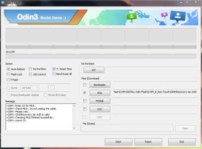

My first sentence to this thread was indeed my phone was like this since i got it out the box, ive had it was past the 14 day period. Im now incredibly tempted to take the battery out and throw it to the other side of the room and rage! It doesnt help that im impatient, the Download screen is still 'Downloading'
Download it and extract it to your desktop then open odin.exe (run as admin) then extract CWM_6_Non-Touch then open Odin click PDA go to the extracted CWM_6_Non-Touch and click on the file in it put your phone in download mode by simultaneously pressing the power button, home button and volume down key when turning it on then plug it in then on odin hit start once finished put this file on your sd card http://g60madman.vmobi.us/d2vmu/stock/vmgalaxys3-stock-clockworkmod.zip and then reboot AFTER putting the file on your sd card by holding volume up + home + power then click install zip and find vmgalaxys3-stock-clockworkmod.zip then click on it then hit yes to install then your prob should be fixed
