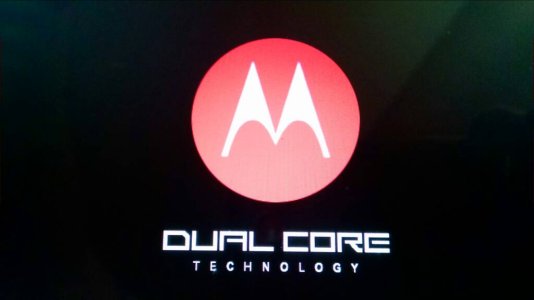

Nothing like bringing an old thread back from the dead. My Xoom won't boot past the big M screen (see attached).
Initially, it wouldn't wake up. It had been sitting on the dock for a few days and was fully charged. So I tried the volume up + power to reboot. It went to the attached screen. No matter what I did it would always come back to that. I let the battery die and fully charged it. Hit power, and it went to that screen. If I hit volume down just after the screen comes on, I get a message about fastboot being enabled. I can't even turn it off now without letting the battery die. Anyone have any thoughts? Thanks.
