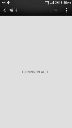

Ever since i upgraded to 4.4.2 today my wifi wont turn on? (HTC desire 601) does anyone have a solution to this?

Welcome to Android Central! You might have to try doing a full factory data reset. Make sure you backup or sync your data before doing so.
hi I have the same issue with my desire 601, but now I fixed the problem, try this and hope it works as it has done for me.
switch off your phone take off back cover, and take out sd card, switch phone on your wifi should be back as it was before, now put back your sd card. hope it helps
It is an intermittent thing; I also upgraded my Desire to KitKat. WIFI sometimes just can't be enabled. Rebooting is your only option. All used to work perfect until the KitKat upgrade :-(
Hi, having same issue. When I remove the SD card, wifi will turn on and connect. As soon as I put my SD card back in, same, wifi says turning on, but will not turn on.
i have got the same issue few days back ......Do not worry
just power off the phone and then remove the battery and again insert it after 30 to 40 sec .......when ur phone will on wifi will be totaly fixed......i know its not any technical trick but it will work ...the reason behind it is that after phone update (kk) software cache memory is disturbed and by doing this the phone will cycle its software to normal ......
