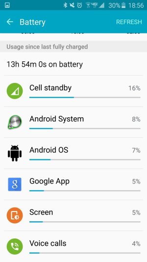

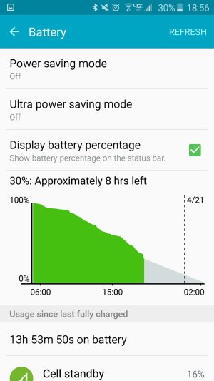

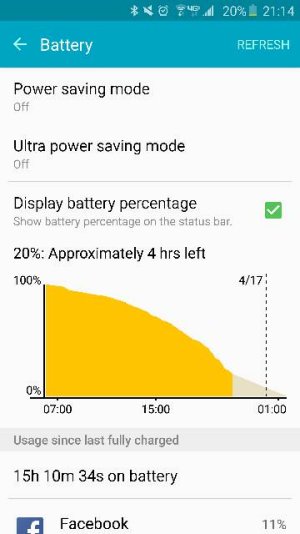

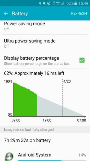

Has anyone else run into this issue? The first picture is from today and the second is from 3 days ago. I had excellent battery life before. Didn't change anything other than updating some apps (of course now I don't recall which ones).
*Edit* I'm right around 2 hours screen time. That's actually not bad right?

There are some apps that are using different percentages now then they were then (orr your mobile network signal just went dead). It would have helped us to figure it out if we had seen which apps were drawing what percent in both shots.
About all I can say now is to check which app is using all that power and check the cellular network strength and the Awake line.

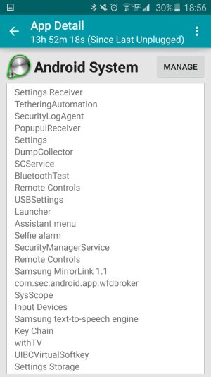

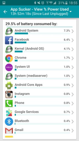

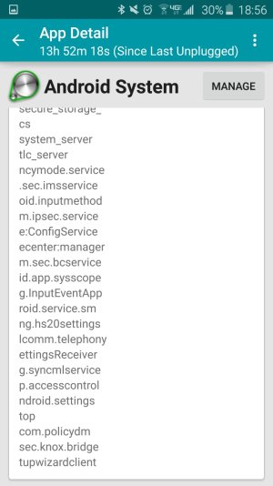

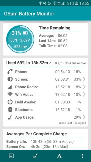

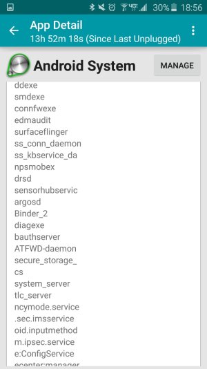

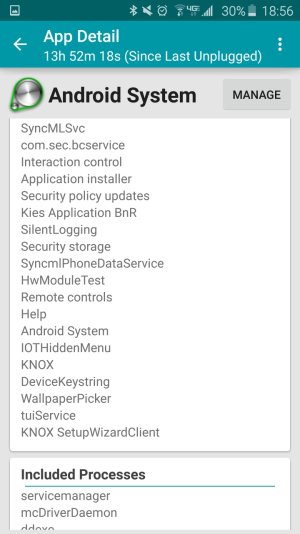

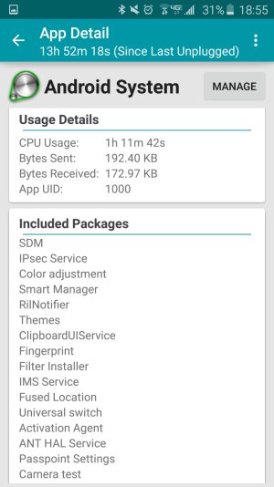

So these are my results thus far today (it's 1900 and I unplugged at 0500). I took a screenshot of everything I could think of that could help.
Please edit your post and insert the pictures into the post a lot easier that way.
My apologies, all set. I haven't plugged in yet in case I missed anything.
Screen on time is a little over 2 hours and phone calls are over an hour.
A lot better now. Well, your Android System and Facebook usage are way too high, Android System may be Location (GPS) turned on and maybe in highest battery usage, you tell us.. for that besides maybe some unusual usage during this past couple of days, like a lot of pictures or videos or still settings things around on the phone, so if nothing like that I'd suggest to wipe cache partition on recovery mode, if not maybe a Wipe data/full reset.
Obviously your Facebook app usage is high but if that's the way you use it then there's nothing else to do there.
It doesn't nt look too bad or different, I think that finding the Android system usage may solve your issue.
Thanks for the quick reply...GPS is off, I will try a cache wipe. I did take nearly 80 photos over the weekend. Not sure why cell standby is high all of a sudden too..I have 4G everywhere I go.
