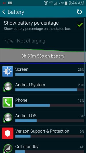

I have not made any calls and my phone usage is higher than normal. This has been happening for a few days now. I re-started the phone and it didn't help.Any ideas? My battery is draining quicker because of this.

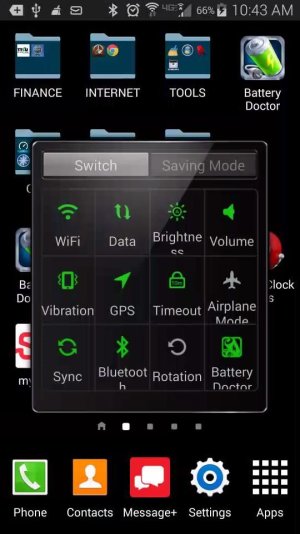

for me, a control freak about this, I use Battery Doctor's Switch Widget.
See screenshot. In this screen shot, everything is shown ON because the green color shows up better than the OFF color which is a faint grey.

The drain showed on your screenshoot is something I only experience when I install / upgrade a lot of apps.
