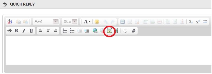

Is the battery new? Did this happen overnight? I mean, this is a 2+ year device...if you're still using the original battery chances are it's useful life is nearing its end. Granted, more than 50% after an hour is not normal even for a dying battery (unless it's REALLY been used in the past). You can post pictures by selecting the "Insert Image" icon on the composing toolbar on top, it would help better diagnose what's going on.

I just got a new battery a day before i posted this, so it not that the battery is old. And it was when i woke up that it happened. And i still don't see the insert image that you are talking about /:

As for the image attachment, here you go :)
EDIT: I just noticed you're using the Android Central App... I'm not sure how to do it from there, the image I posted was when replying in the website.
