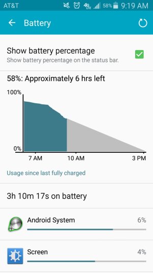

I have a screenshot of the battery drain (looks like I can't upload it here yet). Biggest culprits are "Android System" at 6% and "screen" 4%. The rest of the list doesn't come even close to adding up to the 35% of the battery drain.
I've turned off as many of the notifications as I can (that I can find) and have my email only syncing every hour. Anything else I should look at? Since I'm new to Android it seems like I've had trouble figuring out how to manage a lot of the notifications and sync settings. Would replacing the stock launcher with the Nova Launcher possibly help?screenshot.jpg

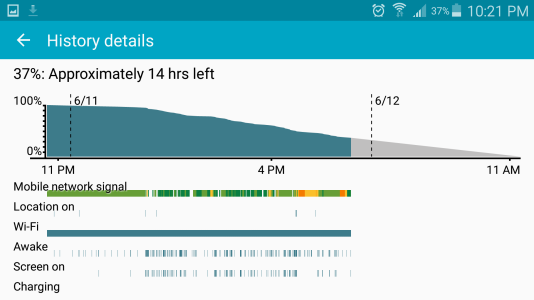

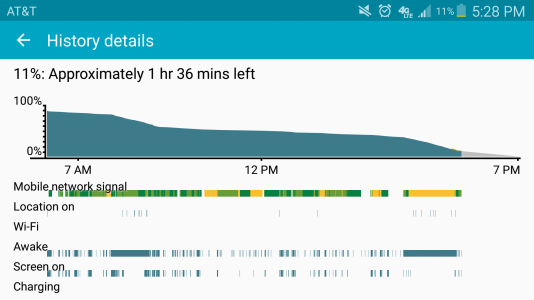

I'll give that a shot. It drained 25% in about an hour and a half while I was at the gym this afternoon as well. I've uploaded the most recent screenshot. I don't really know how to read these, but each time I have a huge power drain is shows the phone as "awake" the whole time. I also notice I don't get text messages during that time as well.

Clearing the cache seemed to help. With normal use (and being unplugged overnight after charging) I still had over 30% left when my day ended. I'll keep my eye on it the next few days.
