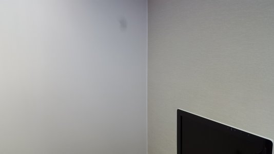

Hey, I've recently bought a S6 and it's only been three days after purchase. Everything was working great, but today I noticed that the rear camera has a black spot on the right side in the middle. I haven't dropped my phone or made any harm to it, I keep my it in a case and my rear camera isn't scratched or anything.. I've tried resetting the phone but it didn't help. Does anyone have a solution to this problem?

Did you peel the plastic cover off the lens?
The lens isn't damaged nor scratched.. And if I zoom in, the spot disappears to the right side

If you put a white background for your home screen do you see it?
If not, It looks to me like something got on the lens or lens cover on the inside. I would exchange it if that's the case.
