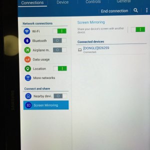

Samsung WI-FI All-Share Cast Hub, Wireless HDMI Display Adapter (Black)
Amazon.com: Samsung WI-FI All-Share Cast Hub, Wireless HDMI Display Adapter (Black): Cell Phones & Accessories
You can find cheaper one on Ebay, I bought an open box for $40. This Dongle uses its own wireless signal so the set up is very easy. Just connect it to your TV's HDMI port, then turn on Screen Mirroring function on your tablet ; when it detects the dongle, select connect, and you're done. This adapter is quite small, just half the size of your hand.

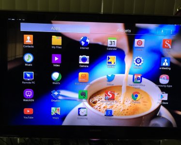

This is the view on my Samsung TV
