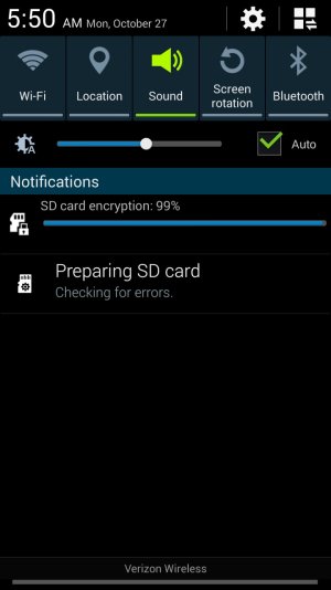

Screenshot of it sitting at 99%
Edit: I'm leaning towards it being an issue with the phone. I just tried encrypting a 2GB microSD card I had laying around, and it gets stuck at the same percentages under the same circumstances as my 32GB.
Re: Problems with Encrypting SD Card
And that shouldn't take even 60 seconds to encrypt.
