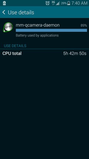

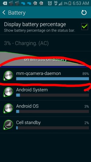

mm-qcamera-daemon issue for Samsung S5
My new S5 is also experiencing this new bug problem that drains my battery because it uses 89% of it.
I read a lot of threads also related to this problem but for Nexus users. Can someone shed some light on how this problem can be fixed please.

It happens to me from time to time and all I do is boot on recovery mode, wipe cache partition and start up the phone :)
Hope it fixes the problem for you.

I read a post about that too, havent tried it yet since cleaning the phone using clean master kinda helped actually. But if it does occur again ill give the wipe cache partition a try. Thank you!
Hello, i was facing the same problem. The cache partition wipe from recovery did not help , clear data and cache in the camera app also did not help. What helped me is a lot of reading. I reached to the conclusion that a third-party app is causing the problem. So here is the needed action - if you have a scanner app delete it, if you have 2 , delete first one of them , if it not helps , the second one etc. If this is not enough then delete skype and see what happens. If not , check for other application which can use the camera.
Best regards
Hi,
I was also facing the same issue from the past 6 month... i tried lot of method to get rid of this issue.. but no result... 2 days back i uninstall viber application and seems the issue solved.. so if u have viber uninstal the app.
