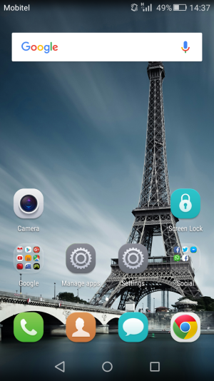

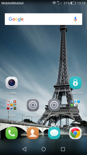

even though there is one sim card in Huawei p8 lite phone,it displays same carrier twice on the status bar,how to get rid of that?

Turns out It's an issue with the sim card not the phone.
Re: same carrier mentioned twice
Well that's weird. I wonder how a bad SIM would tell the phone that both SIM slots are occupied by a card from the same carrier, even when the 2nd slot was empty?
I don't know it either... Thanks for answering...Screenshot_2015-10-09-14-37-36.png

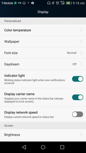

Huawei actually allows you to remove multiple items from the status bar, including the carrier name. While it wouldn't have helped in the case above, if someone just wanted to remove the carrier name from their status bar it's an option.
