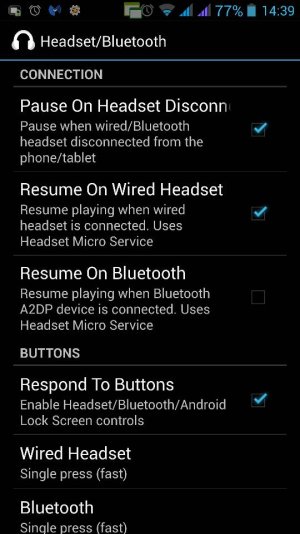

While in the Poweramp app, go to settings then headset/Bluetooth and settings then audio, is it set up to look like this already?uploadfromtaptalk1410702107537.jpguploadfromtaptalk1410702311411.jpg
