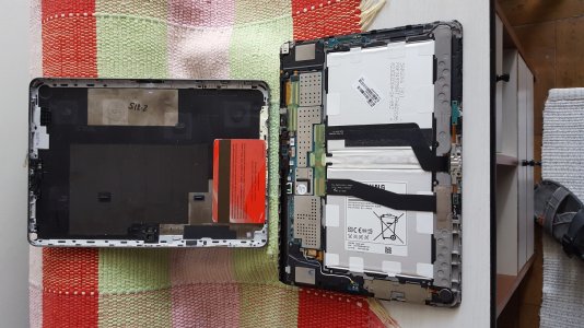

1. The open machine
2. The new card sticking out, waiting for a careless finger movement to pop out...

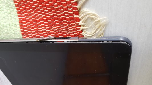

3. The device "lightly seated" on the case.
(Sorry, the uploading process seems to lose the way up...)
This last one is the most interesting: if I only lightly seat the tablet "body" on the case, without fully "clicking" it in, all works well... Perhaps some air is able to pass below?
