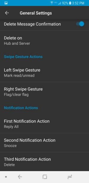

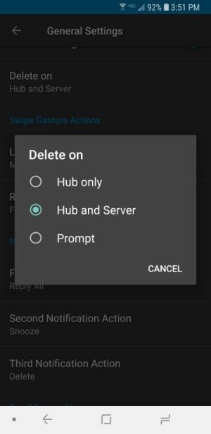

I use BlackBerry HUB for my emails, and it has a setting for that. I looked at the stock email app, and didn't see that setting.Screenshot_20180408-155216_Hub.jpgScreenshot_20180408-155155_Hub.jpg
