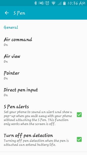

Re: how do you enable s-pen after you have pull it out already?
That's odd, Are your settings turned on?
Seadart1
Mar 21, 2014
7
Air Command does not seem to be possible on the Note 4 once you have dismissed it. I have a 10.1 note 2014 tablet with s pen and there it works well - hover over the screen and press the button. On the Note 4 nothing happens!!! I have tried the note 4 pen on the tablet and that works - so both pens work on the 10.1 2014 and neither on the Note 4. Other functions of the pen work but not Air command. Air command will appear if you set it to come when you remove the pen but once dismissed, it stays dismissed. I notice that on the note 4 there is a single ring under the pointer whereas on the 10.1 2014 there is a double ring under the pointer.
I have tried changing every setting for the s pen I can find and rebooting the device then setting the s pen up again in settings - no luck.
Any ideas anyone? Will lollipop make a difference when that ever arrives in this part of the world - Netherlands.
The device is about 10 days old so I am back to the shop tomorrow.
Seadart1
Mar 21, 2014
7
Solved it!!
First, drink a glass of red wine!!! Then bring the pen close to the screen BEFORE pressing the button. When close to the screen, press and release the button; on releasing the button the Air command will appear about 80% of the time. Keep the pointer close to the screen until after you have released the button.
