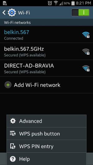

In settings go to "connections" tap and hold WiFi to open it. From the menu button (bottom left next to the home key) select advanced then deselect "scanning always available". Close settings

I can't find Advanced wireless settings anywhere on my Galaxy S4 running 4.4.2 I long-pressed the Wi-Fi category. Nothing happened. I entered the Wi-Fi settings, and all I saw was the list of hotspots and below that, a button to scan and a button to gain access to Wi-Fi direct. I also looked in developer settings. Nothing. It seems strange that the scanner wouldn't have its own settings. Surely, I'm just missing something.
After going into wifi settings , press menu key (left key) to go into advanced settings
