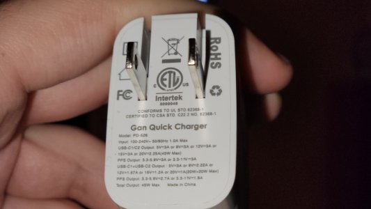

Below this writing will be a picture of the charger I bought.
And before that, the tl;dr:
~3050mA charge current with 15W
~4100mA charge current with 25W
What's your 25W charge speed?

So I didn't give Samsung any more money to buy their 25 watt charger that should've come in the phone box -
I bought an "iCan" brand 45W USB charger at a local PC store instead, cost much less :)
I've noticed though... the average charge speed of my battery using the standard 15W charger with screen off is:
3050mA
For the 45W charger over-spec'd to provide the 25W that can be requested by the S22:
4090mA
just over a third faster...
This isn't over the whole charge cycle, either, so it's not from a slowdown at the top end (as typically happens and happens more and mdd20230530_003934.jpg
