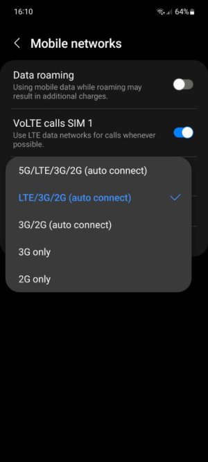

I'm not sure about US carriers but in international Samsung models you can select your preferred Network mode in the Connections settings. This is from an A52s 5G, for example.

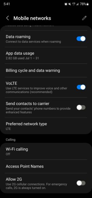

They complaining about band selector not working with new OS software update , but the network selection is working and this is a fantastic app it goes into hidden features the carrier turned off. Screenshot_20220716-174104_Settings.jpg

Verizon won't fix this or Att as they have this blocked from users , but the app I mentioned should get OP going and much easier solution then waiting for something that will never happen untill they decide to toggle it on .
