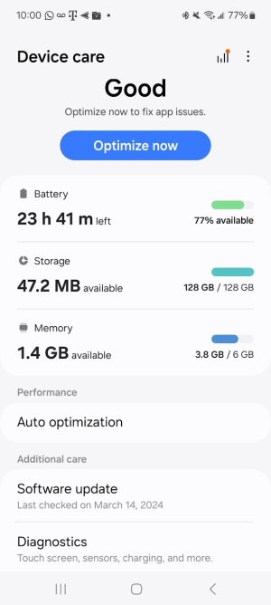

Check in Device Care under storage if you have an SD card

Hmm..
* it says SD on it, rather than something that would indicate a SIM card ... I'll try to figure out some way of taking a picture of it.
* my DEVICE CARE page does NOT mention an SD card. I am wondering if the card in there is a dummy or a placeholder? I'll try to get a photo of it using someone else's phone camera..
thanks again for feedback!
w

Tap storage in device care and see if it's there

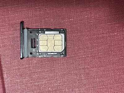

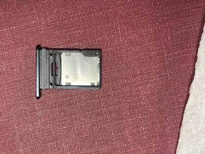

Make sure you're not looking at the SIM card.
The tray for the SIM card and the SD card is the same tray. Each card just uses each side.
SIM card on one side, flip it over, and the SD card snaps in on that side. You have to be careful as the contacts always face out, and be sure both cards are properly snapped in and seated before sliding the tray back into the slot. Maybe even wipe the finger oil off the contacts before putting it back in. Assuming you're using your bare fingers when doing this.

thank you guys! yes, here are pictures of what I am looking at - thank YOU!
very helpful! thanks again for your feedback!
